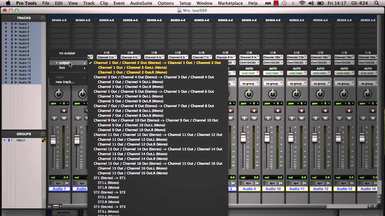

Typically when I fire up Nuendo or Reaper it recognizes my Tascam FW-1884 installed as an ASIO device.
I see all inputs and outputs and rout accordingly.
And control is via Mackie Control Protocol

The USB source can be rapidly switched to local/dSnake on the routing page.
But the QU can’t magic up extra channels from nowhere.
