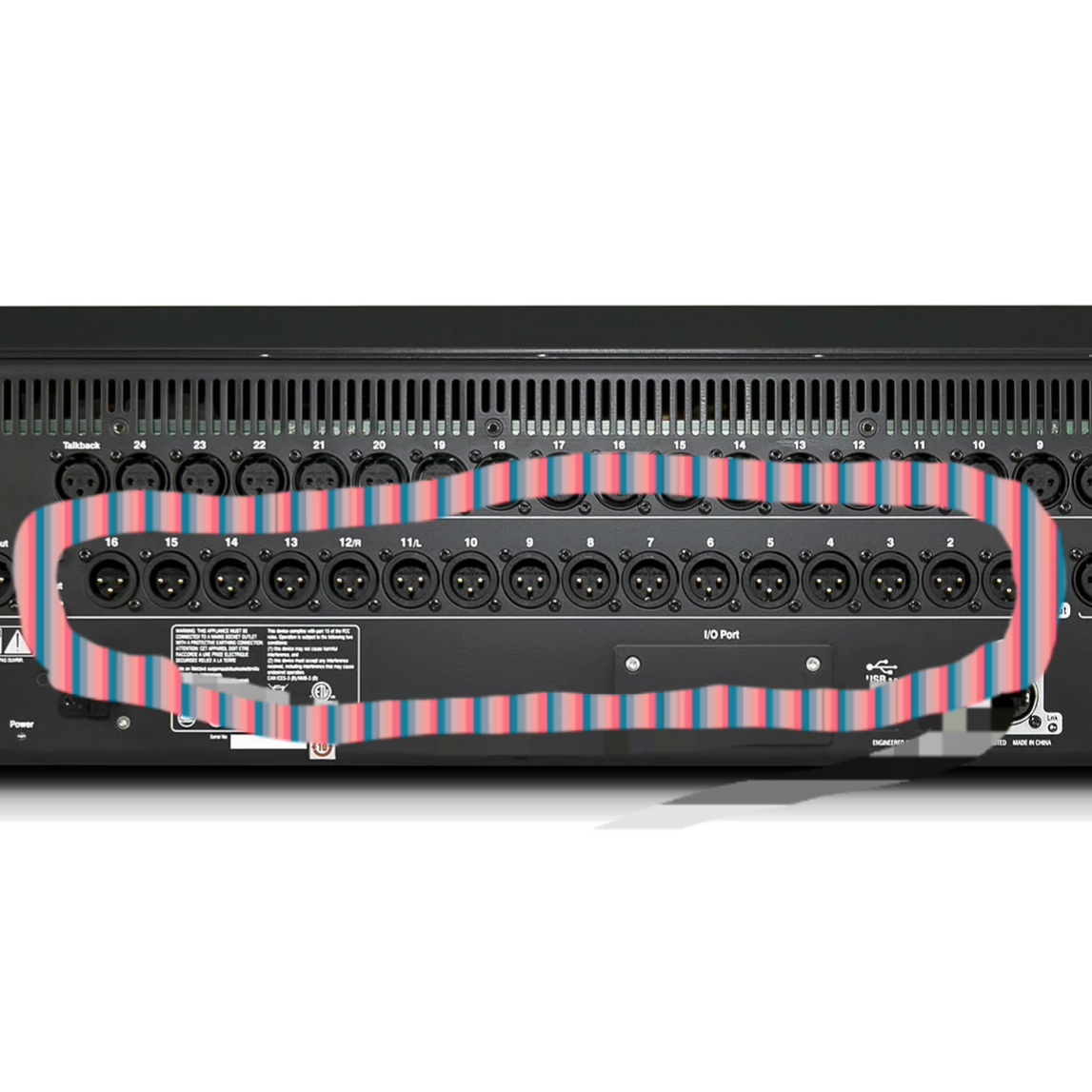

I mean muting an output chanel
What are you calling an output channel?
Yes every output is independently muteable (if that is really a word)
And every output on an SQ can be patched to any mix out that you want.

Hopefully clarifying some of the workings of the SQ will help understand the possibilities.
Input sockets have an associated digitally controlled analogue preamp. The settings you see in the GUI change gain/pad/48V at a hardware level before the signal hits the ADC and from there it’s digital processing.
Output sockets take a feed straight from a DAC but there is no control over this other than that which exists in the digital source (mix, direct out etc…) you’ve assigned to it.
So you can assign a mix to many output sockets, but they will always behave the same way, as you are controlling the single source (the mix) and not the individual sockets.
To achieve what you want to here then, you’d need to use multiple mixes that are essentially copies of one another, either post-fade Auxes or Matrices fed by the main mix.
This will mean you can mute individual mixers and use the mix processing if needed for the different end points too.
