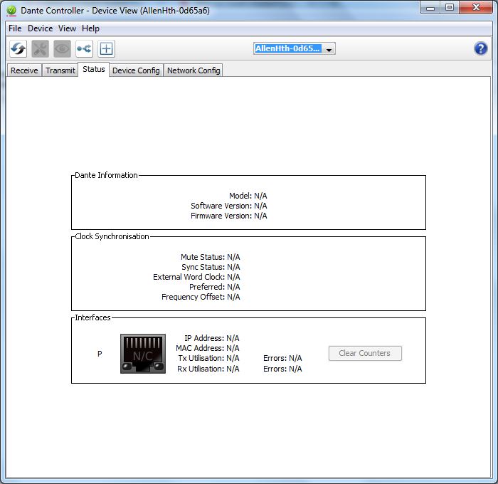

I just installed our brand new Dante card and can’t communicate with it usefully. In Dante controller the status window shows N/A. The device Config window is similarly useless. Cant even see a firmware version to know if the card is out of date. This is connecting Via a switch and directly Card to PC. Primary OR Config port.
Does anyone think the unit is DOA

Hi Drew,
Can you confirm your computer is set to DHCP? What version of Dante Controller are you running?
I have to do couple refresh cycles on my mac if card is shown like this, however in my case sample rate is visible all the time, only latency is grayed out.
ddff
Thanks for the responses.
I was away from the console until yesterday but brought another machine to test with. Short answer is the card is fine, something is wrong with the computer i was using. DHCP is on, wifi is off, PC is patched, NIC Driver is specifically updated, fresh version of Dante controller, new cat5 cables, ethersound service is not running… Weirdness. I’ll have a QL to test against later in the week I’ll let everyone know how that goes. I suspect there is some other piece of software that is conflicting.
D
For the record, our is sorted. Turned out to be some incompatibility with the 64 bit version of reaper and the ASIO drivers. Not an issue with the card per se. Uninstalled Reaper 64 bit and installed the 32 bit version and it worked fine after that.
