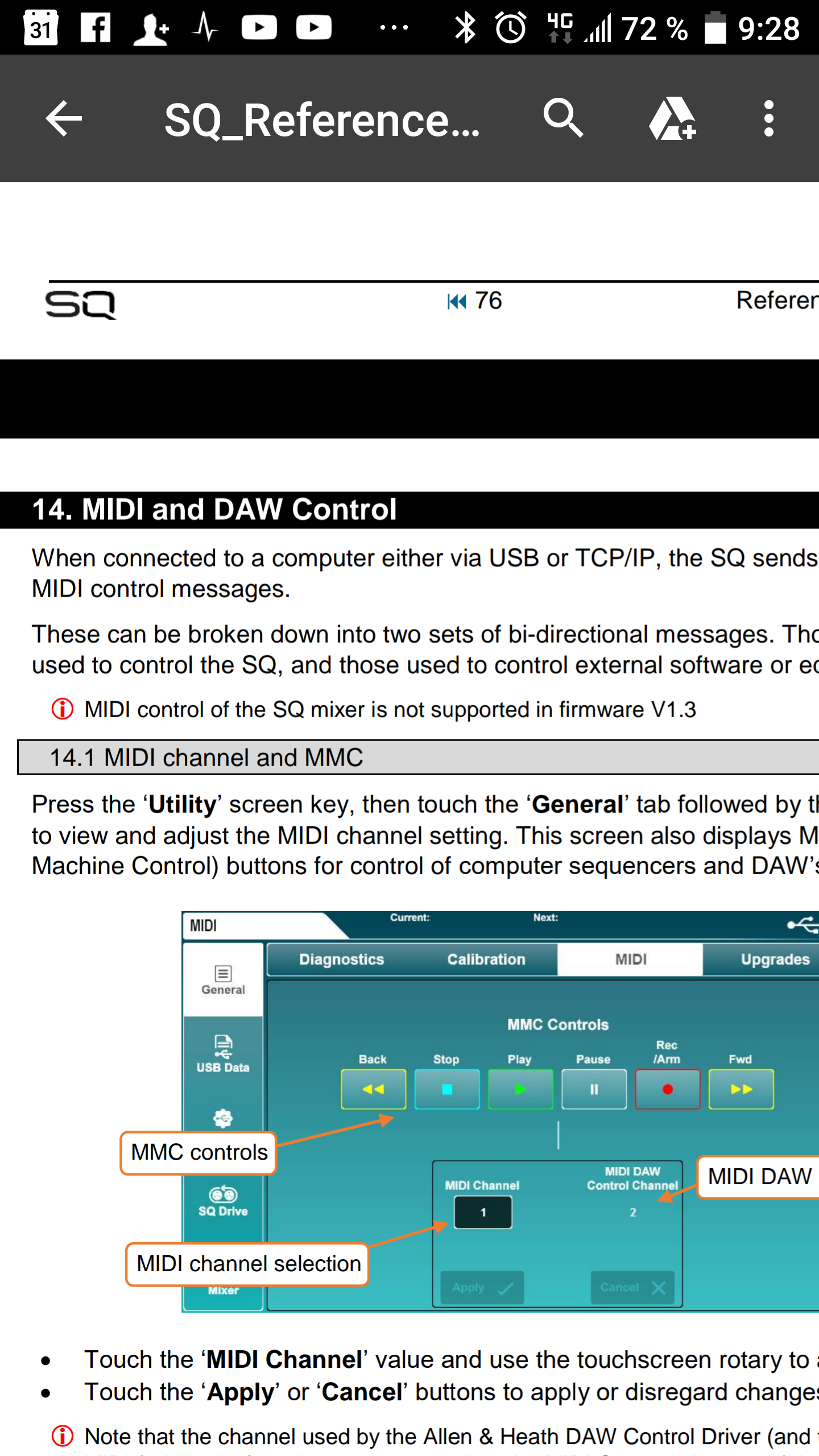

MIDI control of the SQ mixer is not supported in firmware V1.3???
I’m new to sq6, I’m trying to configure as a controller and I found that legend in the manual, MIDI control of the SQ mixer is not supported in firmware V1.3
help please
Hi General,
DAW Control is supported in V1.3, however, other MIDI control over TCP/IP or USB is not yet implemented.
Thanks!
Alex
I appreciate your response, thank you, greetings from Mexico.
Does SQ7 has a MIDI control over TCP/IP or USB? if no what is the timeline for it?
Hi PrenkurJ,
Scene control is controllable using MIDI via the USB port or over TCP/IP on the SQ now, with more controls planned for the next firmware version.
Thanks!
Alex
