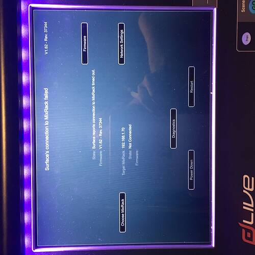

I tried to connect an iPad to our c3500, only to end up with the mixer not finding the mixrack. I did not change any ip-adress, but i did press the DHCP enabled and i see no the web that this might have caused the problem. I have tried the reset switches in the mixrack and i have tried changing ip-adress in both mixer and mixrack. The LED no the mixrack blinks orange so all should be god. All help appreciated!
Displaymessage

Thanks for your answer, i will try and connect a laptop directly to the mixer and see what happens. To me it seems like the reset switch is a dipswitch inside the mixrack (cdm32) but maybe i am mistaken?
Awesome, it was not the dipswitches but the resetbutton you mentioned. All works now :slight_smile: but a strange "error"as i didnt change anything except for pushing the DHCP button on the mixer.
