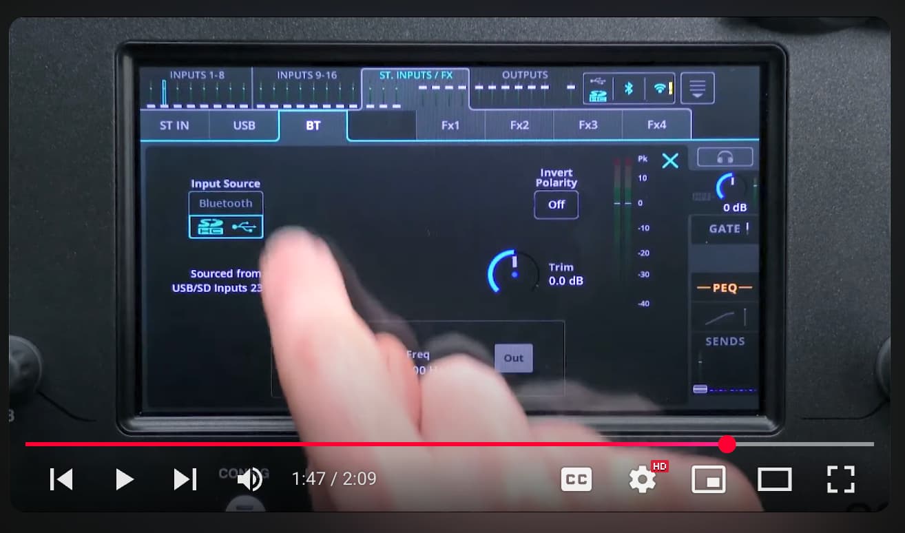

Right now I’m using the USB output for the karaoke software and connecting via bluetooth for the default windows audio output.
In the sound output options in Windows I can see three different devices (USB, ST IN and BT), but I’m only able to see any audio from the one named “USB”.
OK on further inspection I think I might have found the option I need to select
