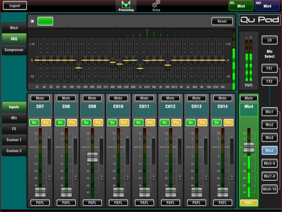

When you are using the Qu-Pad App to ring out the system or monitors, it shows any frequencies that are feeding back as a red light above the corresponding slider control. See attached image.
Use the Graphic EQ fader flip button. It puts the eq on the channel faders and the channel level led’s become the RTA.

I knew about the fader flip of course, but I was using it from the LR RTA screen…unfortunately you can’t see whether or not it’s the left or right side frequencies without counting your button presses on the button. Not a big issue at all, and it’ll be much better using the RTA on the iPad I’m sure.
