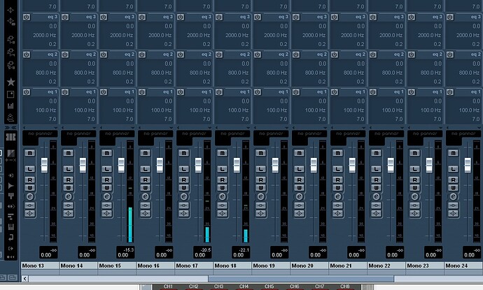

Good day, I have a problem with my QU32
What happens is that I connect any signal to any channel and the signal is retransmitted to channel 17 and 18 …
This happens with any other channel … it is retransmitted to 17 and 18 in the RECORD, not LIVE, in the console this normal …
Does anyone know how to enter the signal sending parameters from Multitrack to PC ???
Maybe something is wrong and you are linking to the recording any channel to 17 and 18, or are in Stereo mode … I do not know …
Help me please …
Hi. I suspect that channels 1-16 are being sent as a 1:1 mapping and then you’re also getting the main stereo master outputs going to 17-18. On my qu24 I get all the channels to my daw but only 1 to 16 (plus the stereo outputs) recorded to the Q-Drive by USB.
Go to Setup - I/O Patch USB Audio to see the mapping.
You can only record 18 tracks to QU-Drive.
