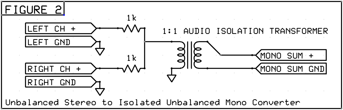

Unless there is some hidden feature to do it then I think you will need something like this:
which is not that hard to build.

Do not use a reverse Y connector to try to directly join the outputs.
