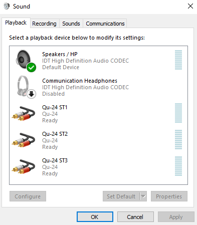

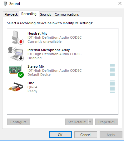

What do you mean ensure Qu is not selected as the standard interface? What should I select and where ? As far as the wifi can I just turn it off on the keyboard? 48k is selected and I have the buffer set to auto.
If you are using the Qu via ASIO from your DAW, then Windows (or any other non-ASIO) application should not be allowed to stream audio through the WDM driver. For that reason the Qu should not be selected as the standard Windows Audio Device (speaker symbol in tray, playback devices). Select something else like the onboard sound device.

I selected computer devices as defaults.I will try a longer latency. Here is my usb info as attached. Also I can use airplane mode to disable wifi and bluetooth. I can’t try it right now as I have to run out the door. Thanks for all your help. Hope this works.
