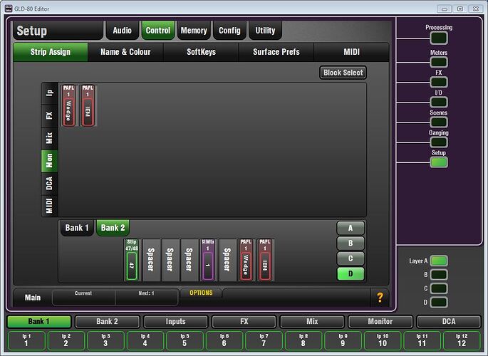

Attached is a picture of where you can find the Monitor Wedge Fader so you can drag one to a spare slot. This Wedge fader works from Main Out or when you press the PAFL button.
Better to use any AUX Mix Fader and assign what you want to that Fader and you have complete control of your wedge.
Regards.

(Make sure “Start” and “End” are the same number or else you’ll change more than you intended to. If you don’t know which number aux you used go to the strip assign page Scott posted and go to the “mix” tab on the left. The aux numbers will be shown there above the name.)
