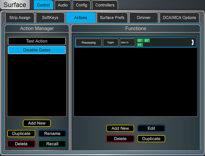

Actions would help here.
It toggles the on/off for the gates of the 3 tom channels, as an example…
Thanks Steffen! I’ll try this next weekend. This insnt’ available on Avantis, correct?
Actions are not yet implemented in the Avantis.
