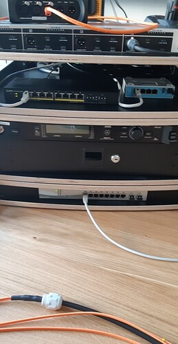

We hade a small Setup und only use dante over fiber links between the 2 switchen. We Ares waiting for the dt168
Actually we using avio and neutrik i/o’s. We have noch Drumset. So we dont need mic Inputs. Als mics are wireless
A picture of the setup
