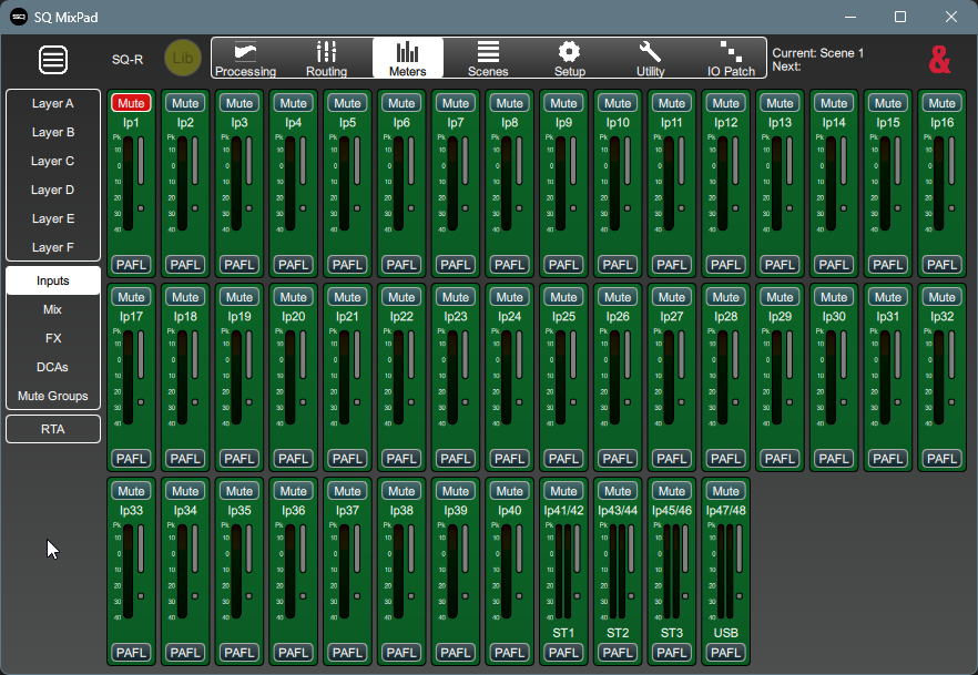

At least it does provide an overview in the MixPad App.

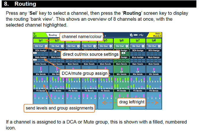

You still have the routing screen.

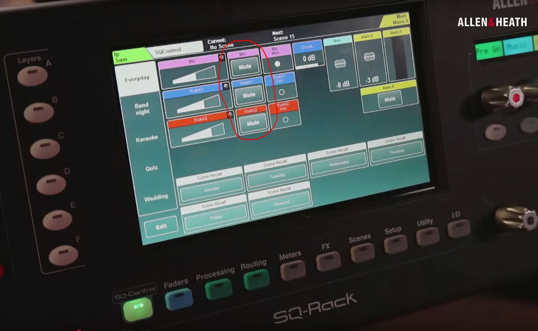

But as an SQ Rack user, you apparently even have a bonus: the dedicated "SQ-Contro"l screen.

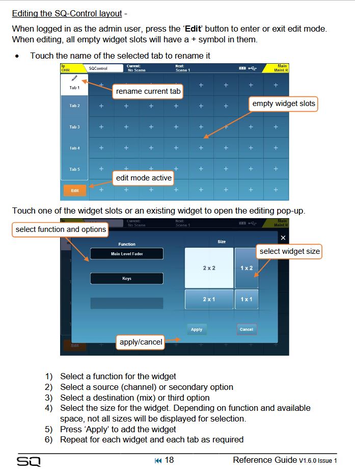

Here, you could apparently create up to five custom layouts and in one up to 48 mute buttons - all at once visible and available for use (like the three outlined in the pic).

Because, considering the possibilities and the concept (see my pic above), it seems more likely intended to provide a dedicated way of operation for non-professionals, such as a caretaker who should only be able to monitor the volume of background music and announcements.

@steffenromeiss you can configure it directly on the SQ-Rack or via the app.
