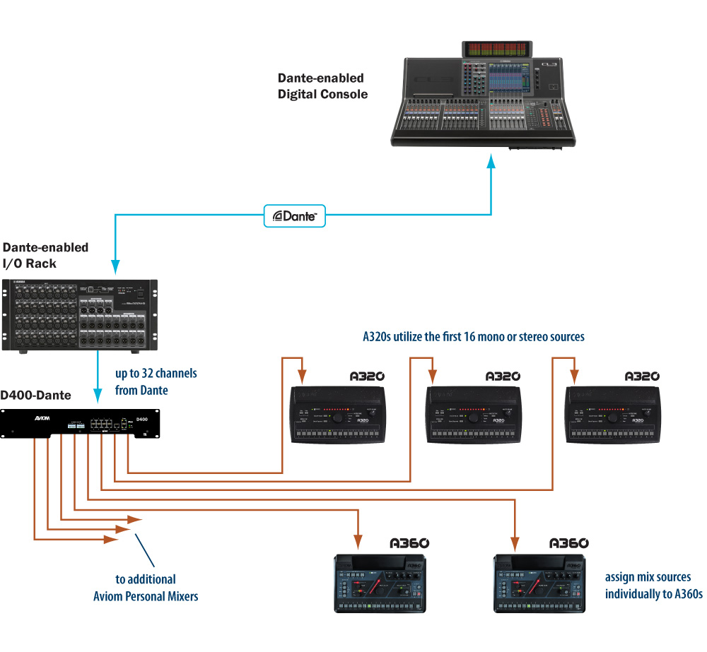

But I have an idea of a workaround: Since you’re already planning Dante card you will be able to network audio to Aviom mixers:
Thanks mate! Appreciate the reply.
Someone over at Gearslutz said the same thing about using the DX168 with the ME systems. The AVIOM gear looks like a good workaround…
Please no, the AVIOM equipment sucks compared to ME’s. [the new A360 is better/closer; but unless you find the APP useful then I’d stick with A&H ME-x series].
FYI ME-1/500 via ME-U can take AVIOM, Dante, MADI, EtherSound, ACE, MMO.
