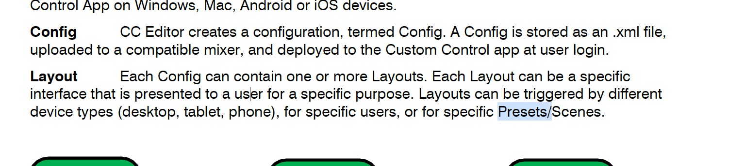

The CC editor pdf, states, layout can be set per preset. But its nowhere described. I only see per user. I believe AHM can set a layout per user in the backend. Im not familiar with that. I only make designs for the layouts.
Does any know more on this subject?
Nevermind, i found it
