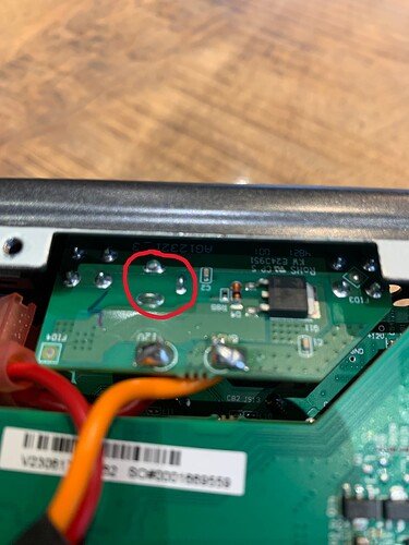

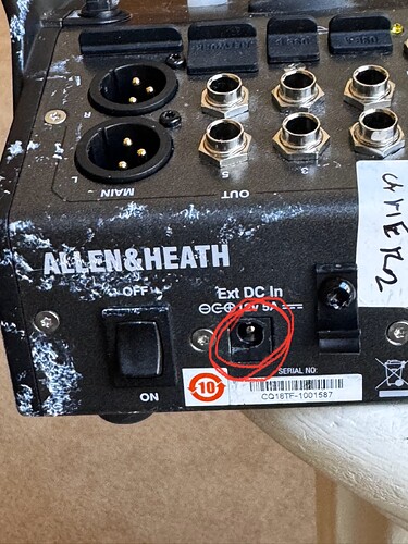

Can you please let me know where could i get “ALLEN & HEATH CQ 18 T” Mixer DC Power Connectors Power Jack Part ? and my “ALLEN & HEATH CQ 18 T” Mixer is not turning ON beacuse of this Bad Power JACK Part. I highlighted with Red Circle
Any help much appreciated
This looks to be a standard 12V DC socket for PCB.
It shouldn’t be too hard to fix with basic soldering skills.
Here is a picture from inside on a CQ12T, layout should be similar on the 18T.
