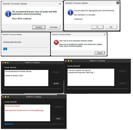

Hello, thanks for the tips. I’m having the same problem (K2 doesn’t connect to M1 Mac) but so far no success applying the firmware update. I have already tried on an Intel Mac and Intel Windows PC. I’m attaching the screenshots of the error messages, any suggestion is welcome. Thanks in advance!
