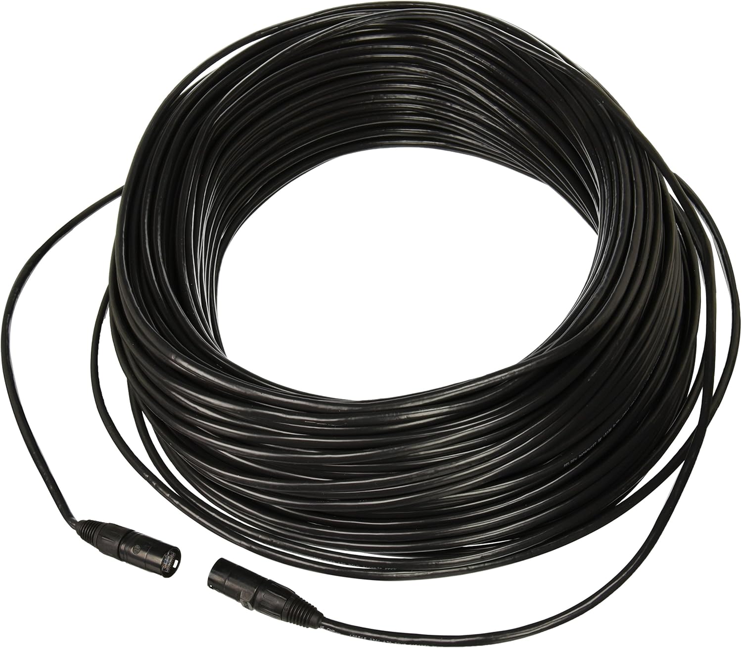

Thanks guys but I’m still not getting my question answered. Specifically - Will CAT5e (not CAT5) that I have now work in regard to phantom power on the AR2412? Like this:

The CAT cable regardless of 5, 5e or 6 has NOTHING to do with phantom power. That is done from the box. NO POE on the cable. Just data.
Thanks! Sorry I wasn’t clear. I do understand that the phantom power itself is “supplied” from the box (or the mixer equipped with it). I just wanted to make sure that the type of cable used is not an issue. This leads me to another question. Is there an advantage using CAT6 or CAT6e over CAT5e?
Rejection of interference is the only possible difference (assuming sane runs) it’s just a 100Mbit Ethernet signal - either it all works, or none of it does…

Cheap will work, but cheap cable is often solid core - and if one of those cores should accidentally snap (which happens if they are repeatedly rolled/unrolled) then you’re out of luck.
Stranded is good for the additional flexibility (in a touring set-up, in a studio it probably doesn’t matter)
I have bought an expensive wire (£150 for 50m on a decent reel) - but I hire the kit out as well, and so the look is important. The ethercon shells are frighteningly expensive, but I’m considering using a whole pile of them in one venue.

I’ve been using the Behringer NCAT5E-50M for about a year now and been working fine,made with Neutrik etherFLEX Cat 5e cable, Neutrik etherCON connectors on both ends and on a reel. Klark Teknik NCAT5E-50M Cat 5e Cable on Reel - 50 meter | Sweetwater
I use the same one as Bear. A little research on my part revealed that this reel is not made by Behringer - it is the same reel that A&H advertises on their website under Qu Accessories and the same reel that is featured for the Midas consoles. It’s made by a company called Schill out of Germany. The price on the Sweetwater site linked in Bear’s post was the best I found for the reel.
