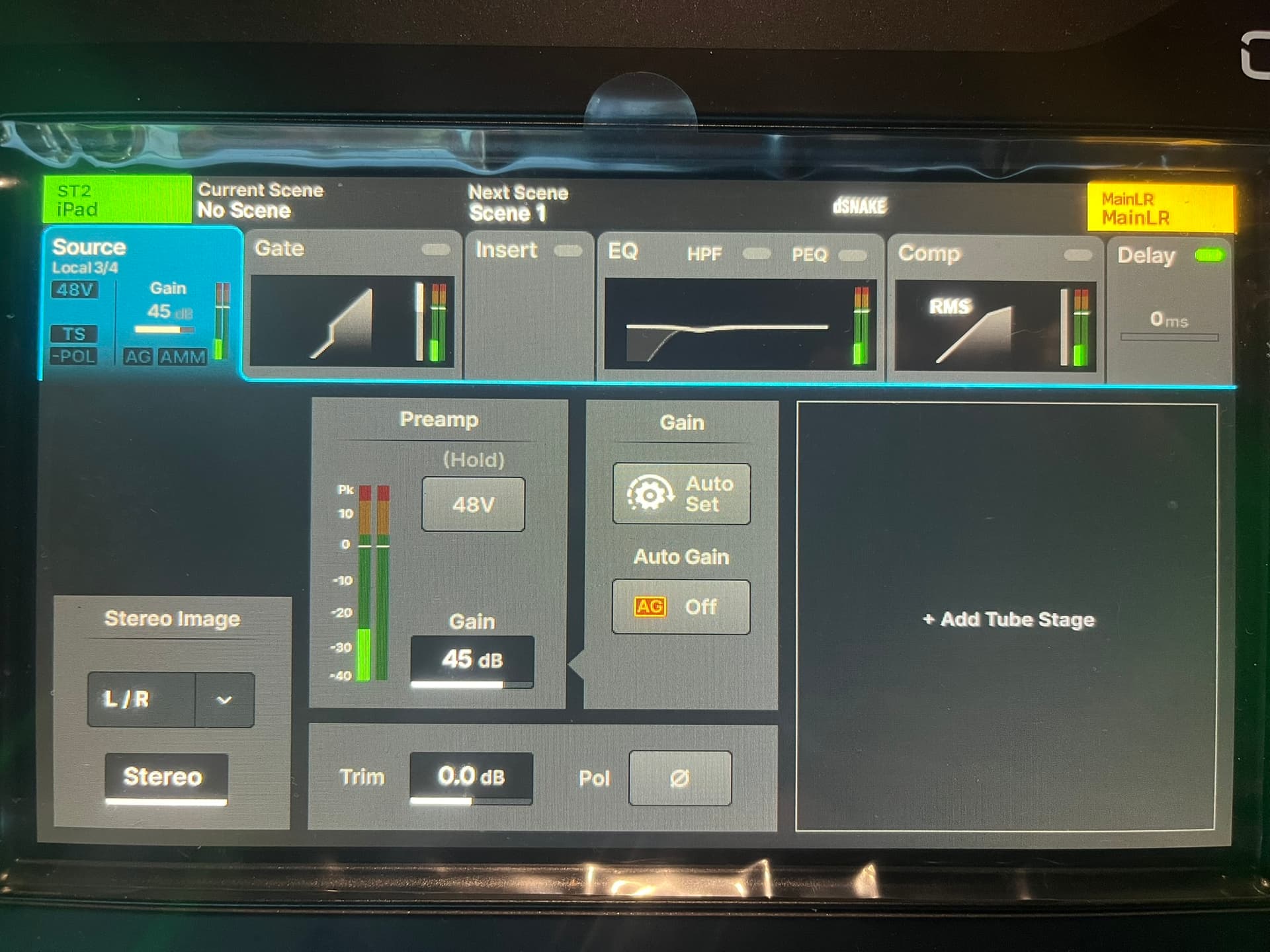

Thank you for the reply. I’ve attached some photos to help clarify.
We are using 3.5mm TRS to dual TS stereo cables for ST1 and ST2. Our setup is:
  • ST1 for PC audio
  • ST2 for other devices (e.g., iPad)
We’ve tested playback from both PC and iPad, and confirmed that their outputs are functional and not muted.
  • In the first photo (ST1), the source shows as “talkbk”, and it does receive signal when speaking into the talkback mic on the Qu-5D.
  • In the second photo (ST2), the source shows as “local 3/4”. We tested by connecting a mic to the XLR input, and indeed, local inputs 3/4 were routed to ST2.
Could you let me know if there’s a solution to this, or if it may be a bug that requires submitting a ticket to A&H?

So I can only imagine that this is a Dante thing as my QU-5 defaults the Source to ST1 and ST2 and there is no way to select another source from the Processing screen of the channel or via the I/O. See pics attached. The I/O screen only goes up to Ip32. I have also noticed I don’t have any Pre-Amp gain options on my ST1 and ST2 which is correct as they are not going through any pre-amps. But yours does.
Are you able to select a source yourself in the Processing screen and does the ST1 and ST2 show up in your I/O matrix Input screen?
