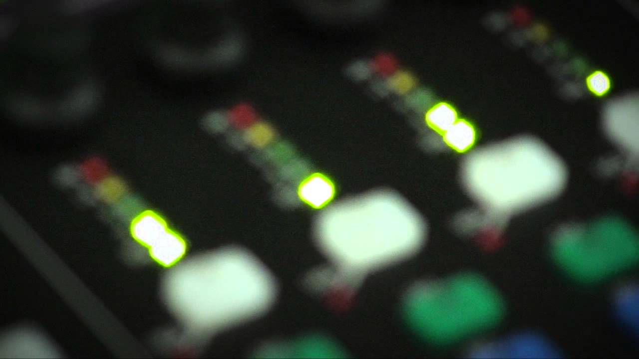

Ahh how do I make aux’s pre fade?
3:10 into this:
Chris
Ok tried this, no luck.
