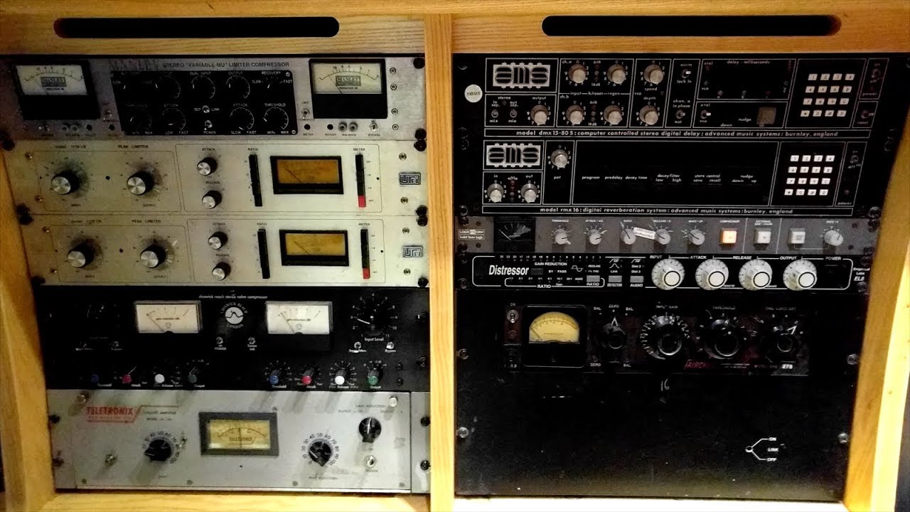

there are some different ways to attach a dynamic reduction (compression) to a signal
opto compression, Variable MU, tube compression, VCA’s and tape compression
all these alter the frequency response different and it also depends on the time constants (attack and release, some introduce a hold time as well)
