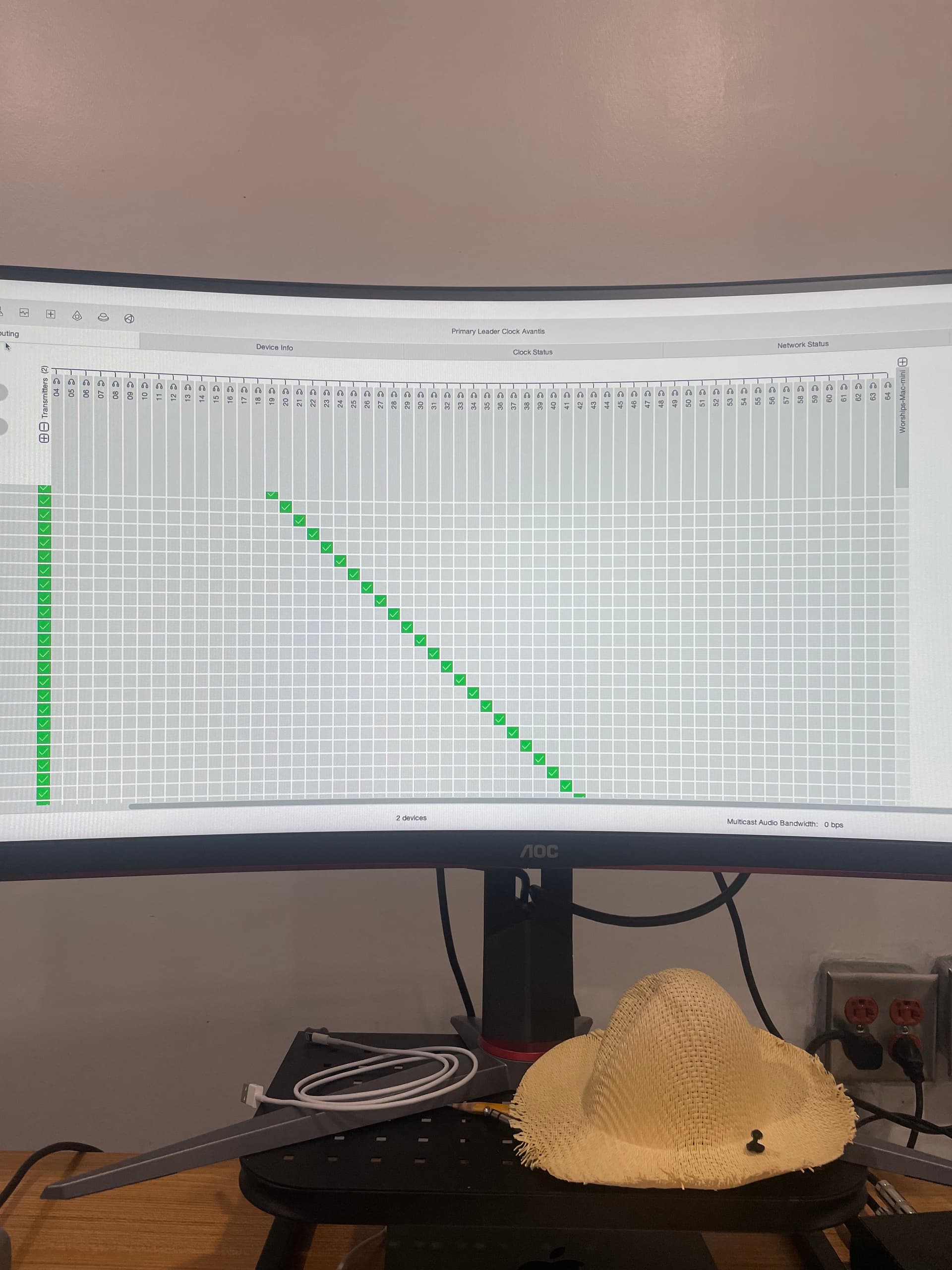

my bad, but spotify I meant our FOH computer that is connected locally to the board. The Dante routing we’ve looked at probably 20 times and it is all 1 to 1. If it’s channel 1 on the Avantis it’s channel one going to the mac mini via dante controller.
I can only post one image currently as I am a new user
That picture continues all the way to 64 with it all being one to one

Can you post an image of your Avantis Dante routing and your logic routing as well?
As you know, there are many places where you have to route the audio through this audio chain and it only takes an error in one place to really mess things up. Your Dante Controller routing looks good, but we need to check the other routing as well.
