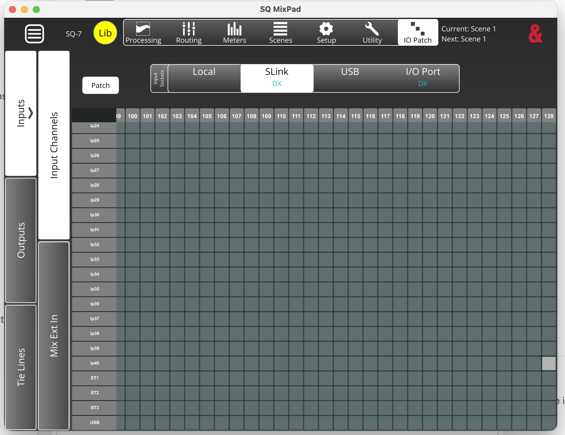

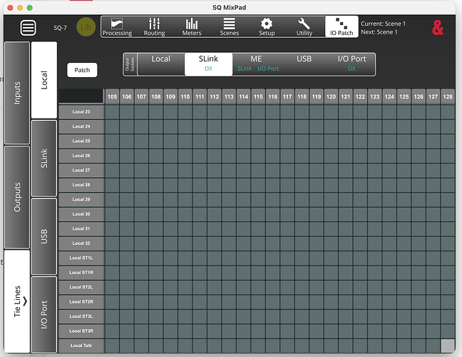

Hey MarkF,
thank you for this info.
Setting up like this?
FOH:
Monitor:
Hi there,
Not quite - do the patching for the Talkback from the talkback menu - unpatch it from IO.
Setup → Audio → Talkback and set the source there. You’ll need to do this on the mixer, talkback settings can’t be adjusted on Mixpad.
OK, but with my setting, i can go to work with two Talkbacks. The one from FOH Set to Input 40 on my Monitor Console sending it to the MIX-Buses (inEar), and using my own Talkback via Talkback-Input on Monitor Console. In Addition I think it would a good idea to route the incoming talkback from FOH (SLINK 128) as Ext in to PAFL Source. So I’m able to hear the talkback from FOH in my PAFL Channel. What do you think?
