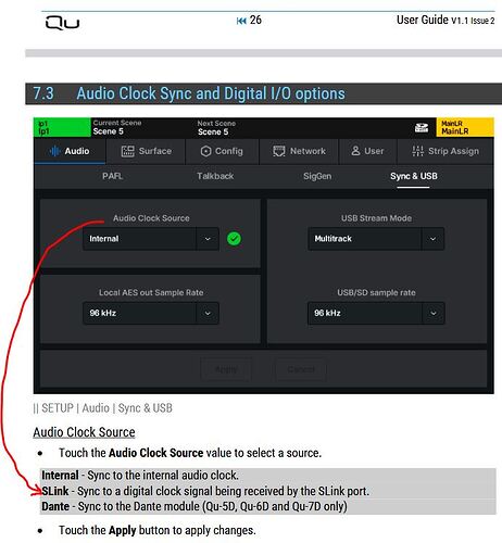

Have you configured your QU so that it is synchronized by the SLink?
I did. When it is on Internal I have a green tick and when I change to SLink I get an exclamation mark and error.

I believe you can connect the QU-pac to the new QU-5 console, but the QU-5 console must act at the master clock. This means the clock in the QU-5 should be set to “internal” and the clock in the QU-pac should be set to “Slink”
As far as I am familiar with the older QU models, there is no option to change the audio clock source on them.
Therefore, this needs to be done on the QU-5 - something the OP likely knew and has already done.
Why this isn’t working in the present case is a mystery to me.
That’s right. There is no option to change the Sync on the QU-PAC so I set the QU-5 to Slink sync.
