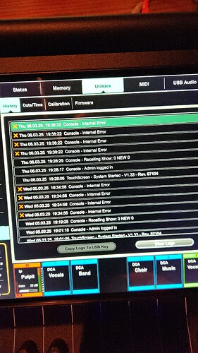

Started having ted triangle blinking after upgrading Firmware from V1.25 to V1.33. History shows “Console - Internal Error” messages. Having that every time after 10-25 minutes of work. Didn’t have this problem on V1.25 ( See photos). Found an article in Reddit with the same problem. Any suggestions?
I just contacted A&H to ask about this error a couple days ago. This was what they said that error means:
“Regarding the error, it simply relates to a device (possibly the one with the IP address above) sending data that the Avantis doesn’t understand. As far as I’m aware, this should cause no problem with the operation of the console.”
The problem is we are having a very similar issue and it causes us to lose control of the console. We aren’t able to adjust levels unless we turn the board off, wait and turn it back on again.
