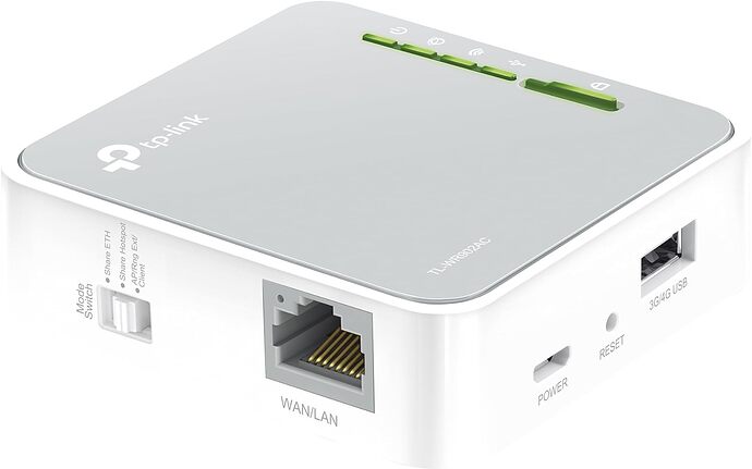

Just get a cheap 5GHz wireless access point and hook it to the Network port
Something like this would work well.
I have used it with an SQ5 and currently use it with a dLive S series with zero issues.
