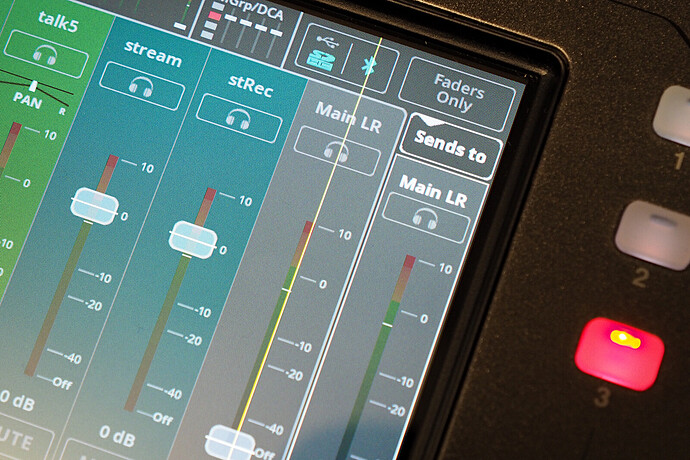

today I took my CQ12t out if its case, switched it on and then this:
A static yellow vertical line - completely independent from what’s on the screen.
Is my screen going to die?
Has any other CQ user ever seen this before?
How can I get this fixed? (I live in Germany.
Best
Doc⁴

Thank you Mark for the quick answer. I will contact my retailer and see what they are willing to do with the issue, and if this should turn out unsuccessful I will contact Audio-Technica then.
There was a slight hope that this was an issue that could be fixed otherwise, e.g. because it is due to a software issue, but as it seems this is a problem with the actual hardware.
It looks like hardware to me. If you’re in warranty, it’ll be able to be repaired as part of that.

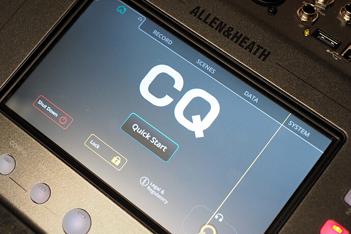

So, my cq12t is traveling to my retailer and I’m hoping this will turn out well.
Meanwhile… yesterday I had a gig with an SQ-6 (not mine), turned it on and…
Pink vertical line from bootup to shutdown always there.

Bad LCD ribbon contact.
Got my CQ12t back from the retailer today. They said they had sent it to the manufacturer (I assume to Audio Technica, that means). The display got replaced and everything seems to be fine now.
In the procedure, somebody apparently did a factory reset on the CQ12t, so in case you wouldn’t have thought of it in the situation: save a show file to USB storage before giving your CQ to somebody else. I had done so, so I’m fine.
