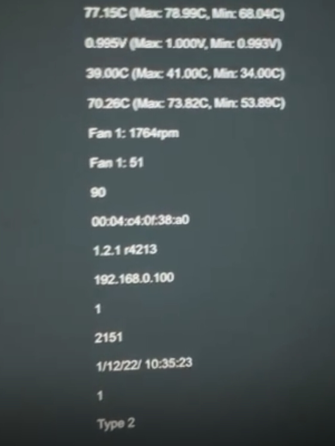

P.S the dac is always around 40 degrees and fan is working perfectly, and the place is indoor and ventilated (it is not overheating)
Attached are the readings of the system
