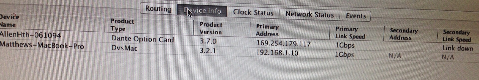

Attached are a few screenshots of my settings
settings images
settings image

According to IMG_7092.jpg, I feel IP adress like 169.254.xxx.xxx is not good, I have this IP adress when network is not detected or something else … have a look at this point.

Your IP addresses show a static IP for the laptop. This should be set to DHCP in order to work with the self discovery protocol in a Dante network. Was this the problem?
I think it was definitely a factor but I’m not sure it was the problem, anyway seems to be resolved now.
