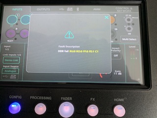

Getting a “DDR fail” message that keeps popping up. Photo attached. Have turned off and turned on the unit several times.

This is the fault description:
DDR fail RU:0 RO:0 FF:0 FE:0 C1

Take it back to your dealer and set up a warranty replacement.
DDR is the memory so there is probably little you can do about this so contact your dealer/reseller.

DDR fail RU:0 RO:0 FF:0 FE:1 C1
Also no audio from the main outs.
In my case, after 2 or 3 restarts it would pass the DDR calibration.
