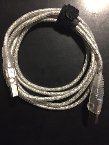

I just received the new QU-SB (Firmware 1.95, Rev 4561) and I had the same noise problems your are describing. I use a late 2012 MacBookPro and a Surface Pro (i7, 16GB Ram). I had the crushing sound on both machines, a little less on the macBook.
After I changed the usb cable, the problems where solved on both machines! I use a cable, which I took from an old RME Interface. It is much thicker than the normal cables.
Probably this helps a few other people out there.
