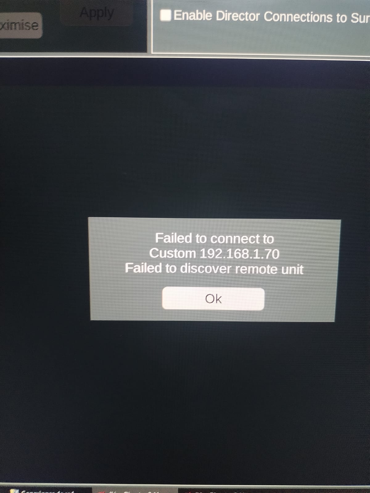

The first issue occurred only once, but the control disconnections have recurred regularly until yesterday, when we lost complete control of the unit (audio was OK). The only way to regain control was to restart the MixRack wich is a delicate procedure because we can’t stop.
The software showed this advice and dissapeared of the online device list
and after rebooting, the unit appeared
then I took a look for the logs:

What does this mean?: “Clock Skew Detected, Resetting Mix Rack Date/Time
And then this message when the connection was totally lost
lun. ago. 11 2025 16:43:21.672 :: CSP: 1-35-35 :: 3 :: -1
lun. ago. 11 2025 16:43:52.412 :: TCP Connection Failed: “Unable to write” – “192.168.1.70” :: 3 :: -1
lun. ago. 11 2025 16:43:52.482 :: 192.168.1.70 Disconnected (AHNet) :: 3 :: -1
lun. ago. 11 2025 16:43:52.545 :: Outgoing Remote Connection: 1 - “192.168.1.70” :: 3 :: -1
lun. ago. 11 2025 16:43:56.562 :: TCP Connection Failed: “Connection refused” – “192.168.1.70” :: 3 :: -1
lun. ago. 11 2025 16:43:56.562 :: Unsuccessful Connection: 1, Code: 0, Resolved: True - “192.168.1.70” :: 3 :: -1
lun. ago. 11 2025 16:43:56.569 :: Outgoing Remote Connection: 1 - “192.168.1.70” :: 3 :: -1
lun. ago. 11 2025 16:44:00.586 :: TCP Connection Failed: “Connection refused” – “192.168.1.70” :: 3 :: -1
lun. ago. 11 2025 16:44:00.586 :: Unsuccessful Connection: 1, Code: 0, Resolved: True - “192.168.1.70” :: 3 :: -1
lun. ago. 11 2025 16:44:00.591 :: Outgoing Remote Connection: 1 - “192.168.1.70” :: 3 :: -1
lun. ago. 11 2025 16:44:04.602 :: TCP Connection Failed: “Connection refused” – “192.168.1.70” :: 3 :: -1
lun. ago. 11 2025 16:44:04.602 :: Unsuccessful Connection: 1, Code: 0, Resolved: True - “192.168.1.70” :: 3 :: -1
lun. ago. 11 2025 16:44:04.609 :: Outgoing Remote Connection: 1 - “192.168.1.70” :: 3 :: -1
lun. ago. 11 2025 16:44:08.621 :: TCP Connection Failed: “Connection refused” – “192.168.1.70” :: 3 :: -1
lun. ago. 11 2025 16:44:08.621 :: Unsuccessful Connection: 1, Code: 0, Resolved: True - “192.168.1.70” :: 3 :: -1
lun. ago. 11 2025 16:44:08.627 :: Outgoing Remote Connection: 1 - “192.168.1.70” :: 3 :: -1
