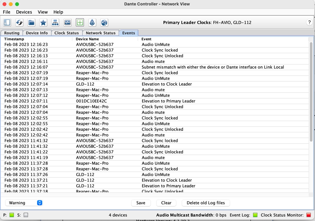

What is the event log in Dante Controller showing?

Here are a couple shots from the Dante Controller.

Something that I have just noticed is that you have TWO clock leaders in your Dante controller. You should only have ONE. This could be the issue. Both GLD-112 and FH-AVIO are showing as clock leaders on the primary network. This could be a switch issue if you’re using managed switches. Check the IGMP snooping settings to make sure that they are properly configured on all of the switching between the GLD-112 and the FH-AVIO device.
Try removing the FH-AVIO device and then with it disconnected, see if you can get audio IN to your GLD-112 from your computer or something else.

Did you address the TWO clock leaders issue?
What kind of AVIO is the unit in question?
I haven’t been able to solve the clock issue. I’ve been on other forums trying to solve that problem, but none of the suggested fixes work.
