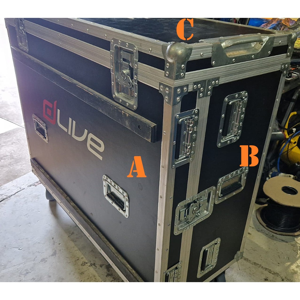

Sounds like a standard road case for a console to me. We have similar for our M***s monitor console.
Technically there should be 3 parts to the case, no?
a - The Base that the console sits on/in
b - The wheeled lid that covers over the console before tipping
c - The top that latches to base and lid, closing it all up
Desk sits in and stays in the thinner part of the case (a). Usually this would have the doghouse too.
To pack it away, you lift the thicker heavier part of the case that has the wheels on it (b) over on top of it and lock it down.
Then you lift it on to the wheels, and put the top (c) on it to seal it up for transport.
So in short, the way you have been doing it is the correct way for this style of case, and is standard.
Edit:
The image you uploaded was tiny, so I am presuming your case is similar to this one, which I have labelled with the sections I refer to…
Thank you for your quick response. Yes. Apologies, i forgot about Part-C.
You have 2 Wood pieces attached to Part-A. I don’t have them. Was this part of the original case or did you add them.
Thanks.
This isn’t my case, it was just an image I found to illustrate.
Most (if not all) wheeled roadcases (a few non-wheeled, too) that I have encountered over the years have the two wooden slats on the base to protect it from further damage when lying down on the ground or wherever. I think they are also known as slides so the case can slide easier on surfaces (again without causing damage) and not catch the handles or other slightly raised parts. Offers a more stable and flat surface for it to sit on when the desk is in operation. Also offers better strength and durability to the case.
Strange that your case didn’t come with those installed. I also see that that case is discontinued on quite a lot of sites that had previously been selling it.
It should prevent the surface from damage, not the case. Just to make it clear.
Maybe it was an extra feature.
