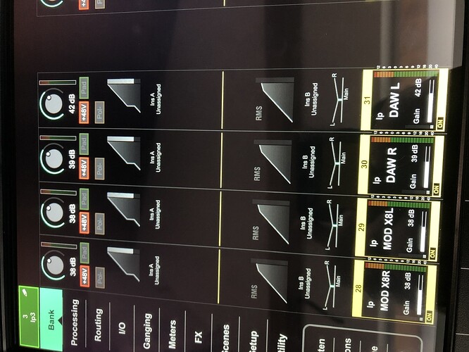

As shown in the this last pic, is the block of inputs 17-24 correct with the setup of (2) AB168?
Channel pic
Also, why on the status window does the SLink shows that DX 1 Primary Link A has a check and B has an X. on the secondary has link checked. since the secondary is the one I’m having issues with, one would think that the secondary one would be the one with the X.
