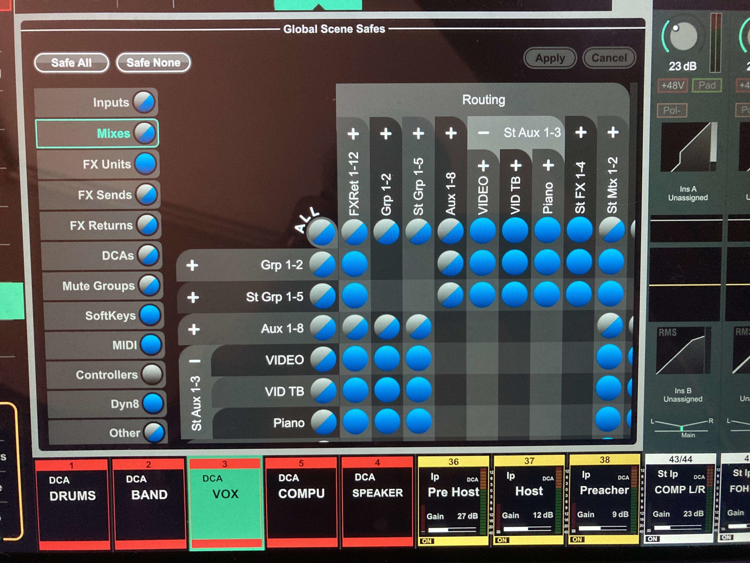

Well we are still drawing a blank. I tried all of your suggestions with no luck. Here is a shot of the global safes page. Stereo Aux 1 is “VIDEO.” Note that there is no blue button under Routing for VIDEO. Could that be an issue?
Hi Doug,
You have a lot of settings Safe in the Global Safes. Not sure if this is intended or not. The issue might be, for example, that the Input routing is Safe (this will prevent any Scene from recalling Input sends to mixes).
What I meant by filters in my post above, is the per-scene Recall Filters, not the Global Safes.

I followed your checklist and it worked just fine! BUT… this only seems to work with Global Safes set to NONE. So I am confused. When we make a scene change we only want the Advantis fader levels to change plus the Stereo Aux 1 levels on the IP8 to change and nothing else. So with then Global Safes to NONE it seems we are in danger of some other parameter not being SAFE. I hope that makes sense. Attached is a copy of our master show. Maybe that will help.
Thanks so much!!
Doug
Wait!!! I think I may have it. I then set the Global Safe routing for Stereo Aux 1 to "allow"as you mentioned and then realized that the recall filter setting as you stated must be copied to each scene. I’m doing this on my Advantis Director on my MAC at home and it seems to work. I’ll try it tomorrow on the board at church. Stay tuned…
