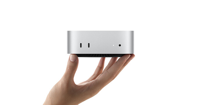

Have you thought of a Mac Mini and a nice sized monitor?

Mac mini driving a small screen yes… that may just be the answer.
In fact there an app for turning an ipad into an extension screen. The mac mini might drive that? I think the app is called Duet. Costs a few dollars though.
Yup. Wireless keyboard and wireless mouse, nice screen(s) and Reaper might well be the ticket. Compact and powerful.
