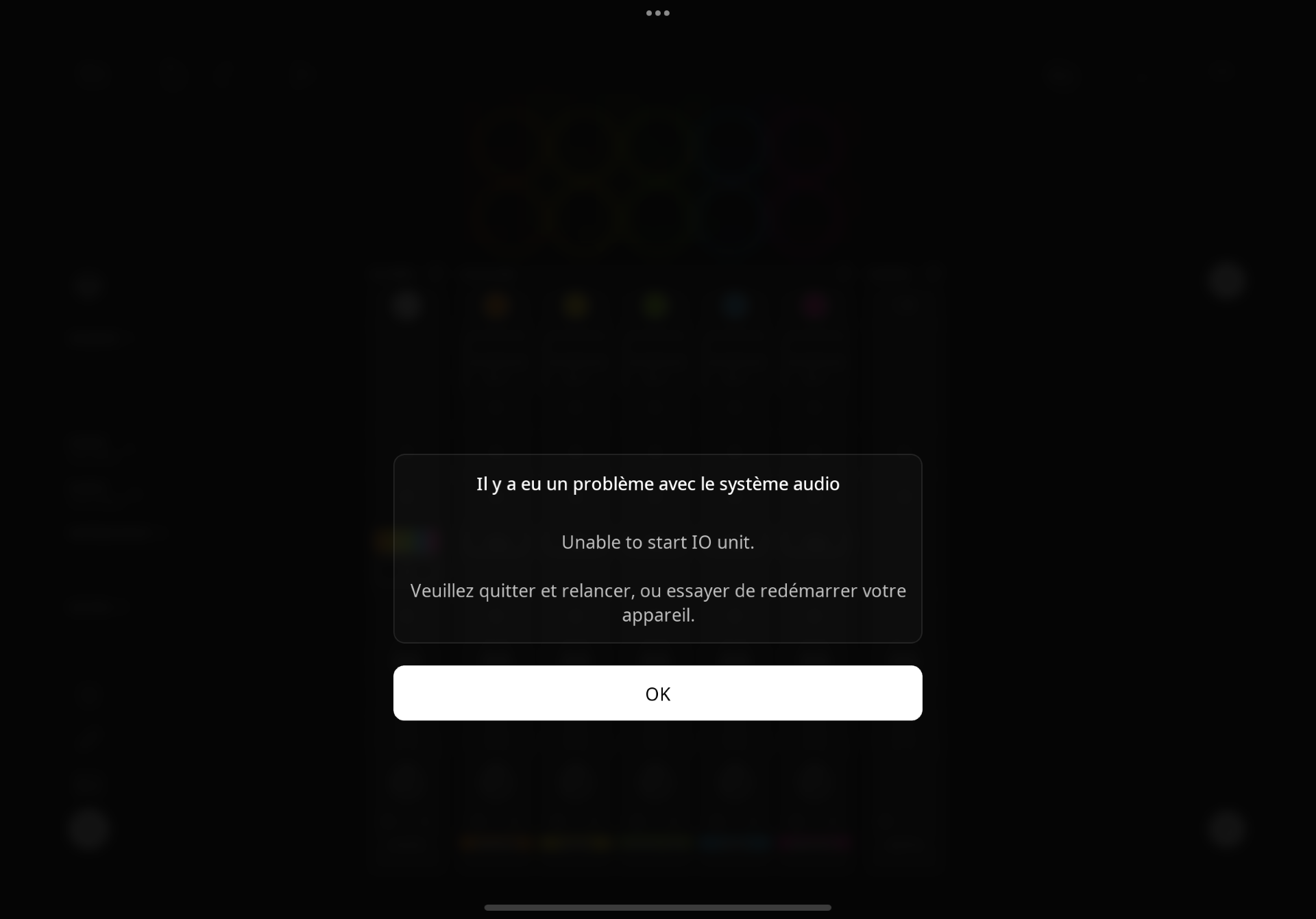

I have constant issue when using Ipad App Loopy Pro with the CQ12T.
The app is running fine until I leave it or close it.
When I want to restart Loopy Pro, it is unable to connect again to the mixer.
I need to switch OFF the mixer then start the app.

Still a lot of connection issue between Ipad an CQ, whether with Stage Traxx 3 or Loopy Pro.
To me it looks like the issue looks is coming from the CQ because when a deconnection occurs I cannot anymore switch OFF the CQ via the Shutting down function and it freeze.
I have to push the switch at the back of the mixer.
