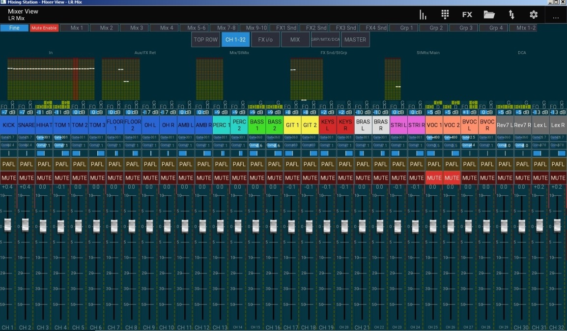

Yep it connects through a network cable. I am not sure if it auto detected it through the search function in the app, or if I had to set it first in my board, but it was pretty easy and straight forward I guess. It works flawlesly in my PC. To me it is quite useful. I find it easier to go to the menu’s, and it is flexible in setting it up to your own taste. That been said, I do not know your expectations for making it worth 20 bucks of course, but to me it definitely was and is. The only thing I find a pity is that I can not (maybe that’s me, lacking in my search capabilities and lazy to read manuals) call up the custom strip which I use for automation in my DAW. Not a big thing to me though as it represents itself of course also inside my mixer inside the sequencer program. Also naming the channels needs to be fit with some consideration to make it look neat.
I use it for many things, some stuff just goes easier in the app than on the console itself. Like I said it’s much easier to go through the menu’s, colourcoding and renaming the channelstrips (visually on PC only of course), do the routing and set up the FX, the bigger meterbridge is also a great future for visualizing all signals on one screen. Now all that been said, I have to say I use multiple screens, so one screen contains the Mixing Station, which makes it very convenient to me. Anyway, not really knowing what features you are looking for, I just threw in a few options. I will add a few pics one of my layouts
Would you happen to have a link to your setup design in Mixing Station? Thanks.
