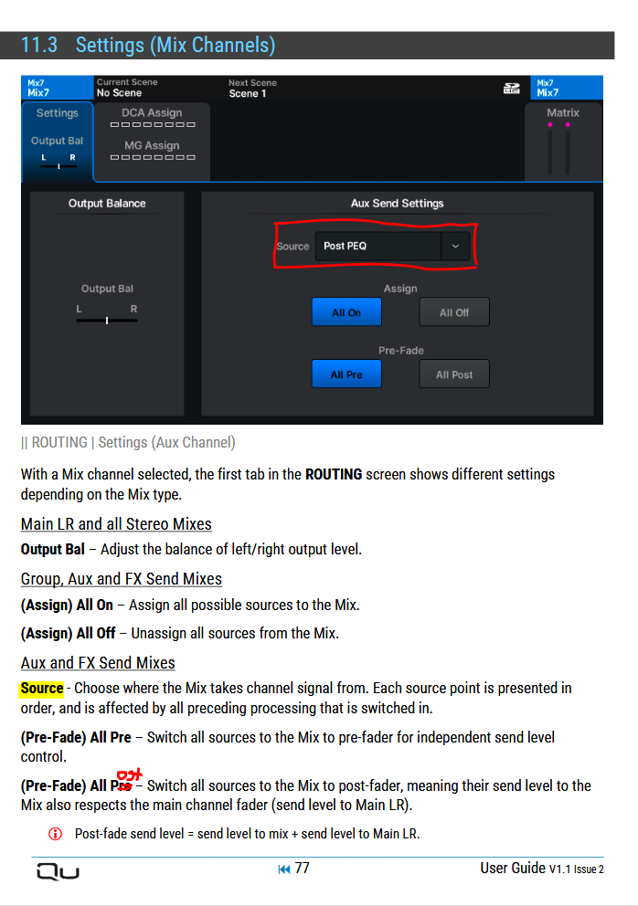

Currently, your only options for routing input channels to aux mixes on the newest Qu series is pre/post-fader (unless you’re using a group mix). It would be nice to choose where in the mix chain the signal is tapped, like pre-eq for tape out, pre-comp for monitors, etc. Hopefully this doesn’t change the architecture of the processing, but it would make mixing for multiple destinations on one Qu mixer less challenging.
Edit: apparently this is a thing already and I’ve just not found it on the mixer yet; sorry.
In the Aux Send settings you can already choose between the 4 source points Post Preamp, Post PEQ, Post Compressor and Post Delay/AMM and switch these Pre- or Post-Fader for each channel.
Hmm, don’t know I missed this… I must have been in a hurry.
Here it would be:
