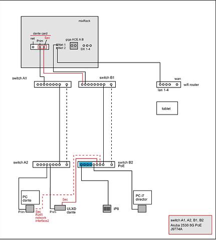

Hello Jay,
Your solution in point 2 with 4 switches i made a scheme and want to ask if i understand it correctly.
Thanks
