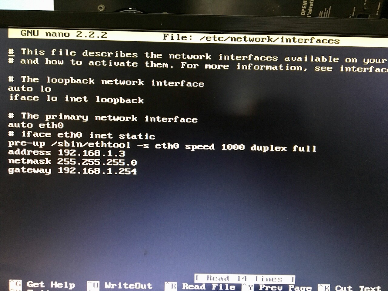

I edited nano etc/network/interfaces
Made it static and added
Address 192.168.1.3
Netmask 255.255.255.0
Gateway 192.168.1.254
But this made no difference

Do these settings look correct
Does anyone have a list of things that need to be entered into ubuntu in order for it to see the mix rack and surface?
Ok, so it looks like I’ve fixed it! I was configuring eth0 (because that was what all the forums were telling me) but when I checked it, it was saying no such device and only eth2 and eth3 were showing up so I configured them and it worked! I’ve now got it connected!
