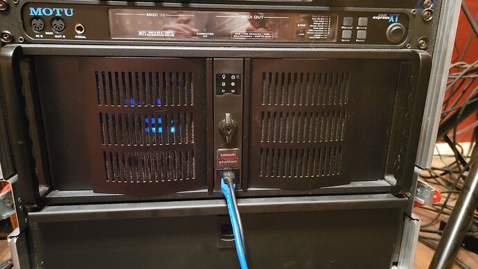

I purchased the Creation Station computer from Sweetwater. I don’t know why it works, but it does.
it is very practical a computer in rack version, good choice.
you have which version of windows 11? v22H2?
Definitely a space saver for sure!
