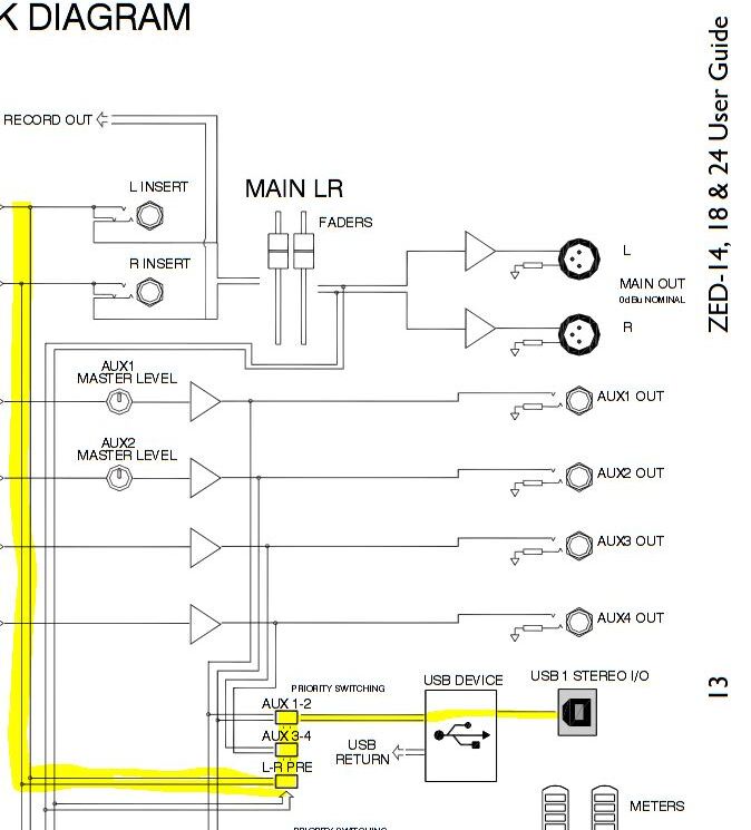

***There are 3 ways of routing audio to the USB soundcard, either using the Record Bus, the Aux-FX bus or the Main L-R Bus, to select which, you will need to assign the USB OUT
Source selector switches.
If recording using the Record bus, check the signal strength on the channel is OK by
monitoring the Channel Input levels, to do this, enable Listen on the channel you are
recording to monitor the Input signal on the L-R meters.
Adjust the channel Input Gain so the signal reads around OdB on the meters, making sure
the signal is not too hot so as to leave headroom for any potential peaks during the
performance. With the Input Gain set and the Record switch enabled, if you then adjust the
Channel Level this will send the audio signal onto the record bus and into the recording
software via USB. ***

If you haven’t pressed any of the three buttons, the same LR mix that heard from the speakers should be recorded.
And if you find the music pleasantly loud in the room, it can’t be missing in the recording.
That could really only happen if, for example, you were recording your monitors Aux 1-2 with the upper button pressed and the CD wasn’t mixed in there.

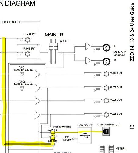

We moved (combined) both monitor speakers to Aux 2, thus freeing up Aux 1. We depressed the Aux1-Aux 2 button below the USB connector on the ZED 24 so we can control the audio level going to the recording device separate from the audio level in the Sanctuary. There were also changes inside OSB Studio regarding the Mic level. I believe he said it was originally around -40, and he brought it up to 0db.

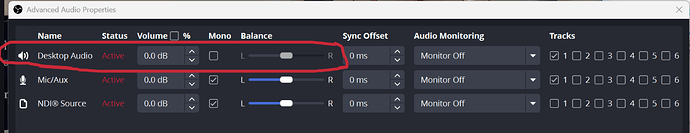

I have OSB Studio on my laptop at home and did some experimenting. I do not have a mixer, so I played some Bible Gateway scripture in audio mode, and let the microphone on the laptop pick that up. I noticed if I raised the mic more than 5db, I started to hear the echo. Raising the mic to +20db would exacerbate the echo as expected. Also, I noticed if I changed the desktop audio to -12db, we also experienced a nasty echo in the video recording.

Either internally within OBS or your sending audio back into the mixer via the USB creating the audio feedback loop.
There is a monitoring function in OBS, try turning that off.
The USB routing switches are in pairs of aux 1 &2 and 3 & 4.
Since your using aux 2 for monitors I would not use the aux 1 2 mode for recording, set it uo with 3 4.
Thanks Mike! I agree that there was some sort of audio feedback loop, but it is gone now and I am not sure what I did to fix it. As someone who fixed mainframes 50 years ago, I pride myself with using methodical troubleshooting techniques but I cannot point to what resolved this issue.
We use Aux 3 for a Williams listening system for those who are hearing challenged. In OSB I did toggle the monitor setting, but it was initially off.
I am not sure what took away the “blue line” in the Balance section for Desktop Audio, but it correlates to with the problem being solved.
