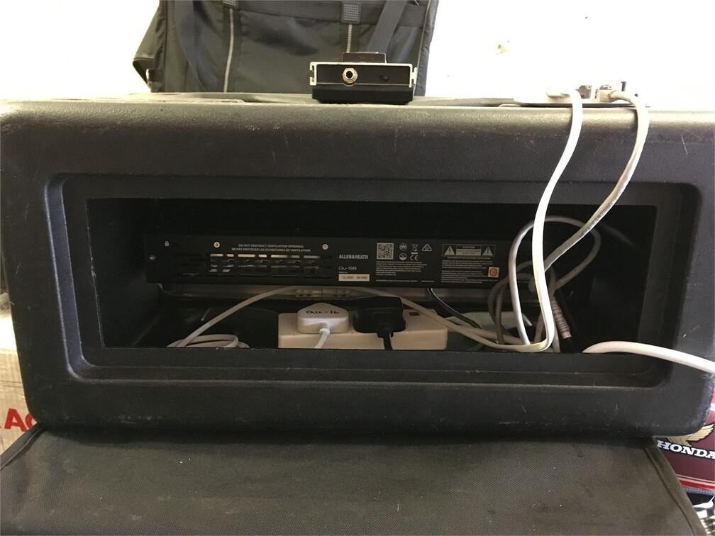

I managed to pick up this shallow SKB case from one of the music gear selling groups on Facebook last week, only by chance I came across a seller from my part of the NW of England that had advertised this case for sale some months ago, but hadn’t attracted any interest. I managed to get it for £30.00.
The lid is deep enough so I can keep my ethernet cable and USB thumb drive plugged in permanently. It isn’t big enough to house any other rack units, but that wasn’t the goal in this instance, and there is hopefully enough ventilation to prevent premature shut down.
