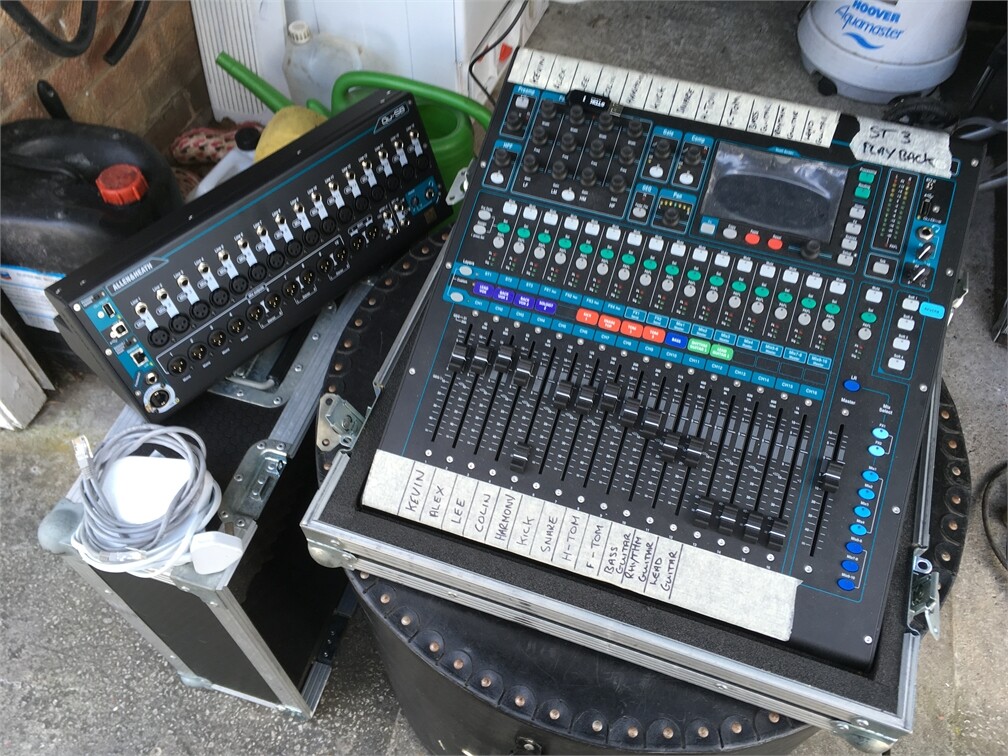

So move on to yesterday, I have just bought a QU-SB for the purpose of using that with the band and using the QU-16 for FOH work I undertake from time to time when the band schedule allows.
I set up both items side by side, my thumb drive that has all my saved scenes on was popped into the QU-SB USB port, like the others, it can see the scenes saved on my thumb drive but won’t allow me to copy them across. So I ended up having to copy the last scene on my QU-16 and enter all parameters manually into the QU-SB to create a new scene that could be saved.
