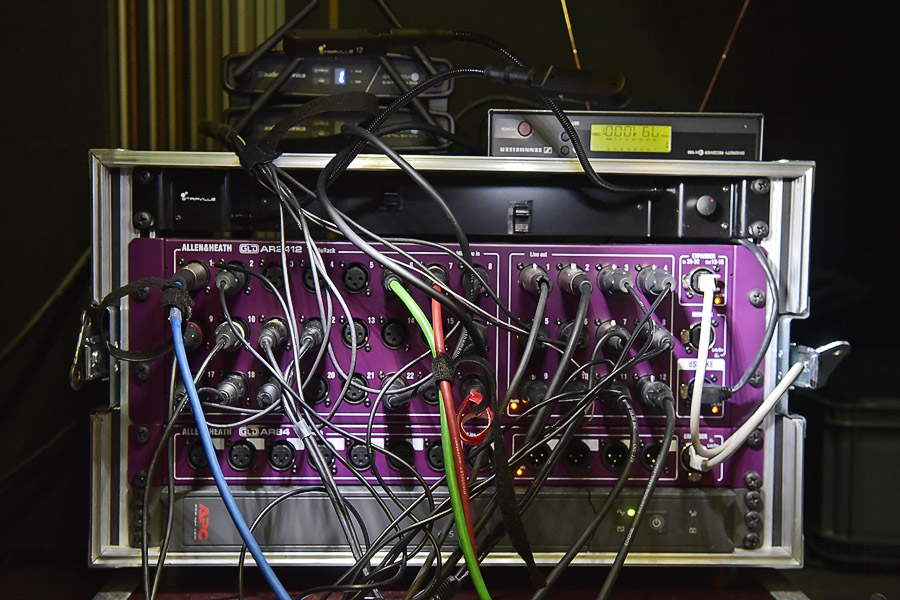

When I built my setup around the Qu32, I exactly had the same question, but I finally decided to went the other road. My stage rack not only contains an AR2412 and an AR84, but also hosts a (line interactive) UPS, a network switch to split dSnake from LAN traffic, a WiFi Router (secondary one, primary one hosted in mixer case) and some rack lights. My whole FOH system is sourced from that UPS and it already safed me twice.
Yes, it is heavy and, yes, I still wish to have an additional AB168 on larger stages but this proofed to be a rock-solid setup for me.
Nice looking rack setup Andreas
So it the UPS the one-U rack under the AR?
Is that the TPLink managed switch?
Do you find it sufficiently reliable?
yes, the 1U Smart UPS SC450 is at the bottom, slightly overpowered and heavy (10kg/22lbs) for this purpose, but the smaller one was out of stock when I configured the rack.
The managed switches are TPLink TL SG105E (50 Euros/pair) seem to work nicely in this setup, at least I never had any problems from dSnake or WiFi connectivity yet. Sole purpose of this setup is to have a second WAP on stage, but in fact my iPad still prefers to connect to the AirPort at FOH. In case of any problem I still could connect directly, so I’m not bothering using more high-grade gear.
