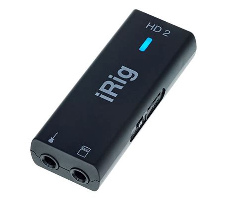

IRig

That’s a slightly different version iRig than the ones I have but it does
have the 1/4 insturment input jack.
