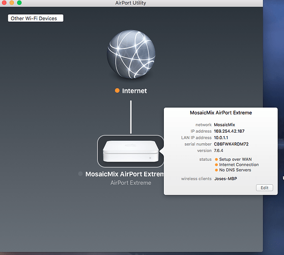

Yes, I am using a 5th generation Airport Extreme & can see the IP address via Airport Utility.
I restored it not to factory default & now having IP Address & Subnet Mask Only.
Cable is tested, same cable I used now to re-set-up the airport extreme.

Though after, restoring to default, I am only seeing values for IP Address & Subnet Mask. There is no more Router Adress.
pls see attached pix.
also, the Qu-Pad is prompting to enter an IP Address. I tried entering the router’s Ip Address but still not working.

Yes Know where to see the QuPac DHCP setting. It has a default Ip, subnet & gateway. Please let me know how important are these default values.
Yes I can also see the DHCP table in the router if you mean viewing the router in computer or via settings of the ipad upon connecting to it.
I really do not understand it as I am not familiar with networking.

At 7 you should enter the IP of the QU
If you look at the DHCP table on the router it should list devices which have connected with their MAC (physical address, doesn’t change) and their IP (which can change)
There is a second page - with firmware info at the top - which lists the current IP (as opposed to the default which isn’t used when DHCP is enabled)
I also checked it but there is no value in it even after setting up the router.
Pls see attach. I am beginning to think there is a defect in my newly bought QuPac.
